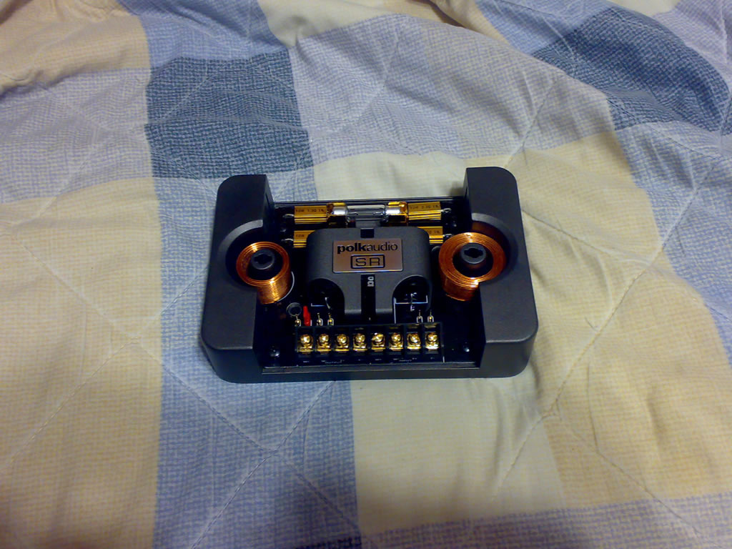

    I already buy KnuKonceptz cable 16 gauge, but im having problems with the crossovers, because they are huge, and i cant figured out, where to put them..
    is it true, that they are suppossed to be near the driver?, or can i put them in the trunk next to the subwoofer?

    I have my momo components right beside my amps in the trunk. I don't know the magnet in the subwoofer will interfere with any of the components inside the crossover, though.

    They do not need to be near the drivers. But, you do have to run more speaker wire the closer you put it to the amp.

    That is what I did when I was running my Rainbow Germaniums. The x-overs on these are pretty large. I hid them behind the trunk finishing material. I kept it the same way for my Profi's since all the wiring was already there.

    I already install the crossovers, well actually i went with a friend of mine to help me since he is a profesional installer.
    we put the crossovers below the dashboard, above, the carpet, so no one can kick them.

    Quote Originally Posted by Kinetic View Post
    Hey, quick question since you were just playing with the crossovers. Do the connection points on the crossover and speakers work better with ring terminals, or with bare wire? I'm buying all the wiring and distribution blocks I'm going to need to put the speakers in but dont know if I'll need ring terminals for every connection. I know my amps are setup for bare wire compression connections but not sure about the speaker end.
    And btw, after I saw how huge the crossovers were, I'm planning on mounting them on the rack in the trunk along with the amps. (essentially mounted on the sub box)
    /////ALPINE INA-W900 HU
    /////ALPINE PXA-H100 DSP
    polkaudio SR5250
    JL Audio HD600/4
    polkaudio SR124DVC
    JL Audio HD750/1
    "In this house, we obey the Laws of Thermodynamics!"
  28. #28
    Member Sales Rating: (0)
    Join Date
    Oct 2007
    Location
    Mexico
    Posts
    398
    Default
    Quote Originally Posted by frosty2k View Post
    Ok I you can use the bare cable on the crossovers if you want, but personally I prefered the ring terminals.
    so, the amp has its own gold plated speaker terminal
    http://caraudiosecurity.com/shop/ima...600-extra1.jpg
    then the cable goes to my crossover with gold plated ring terminals (but it can be the bare wire)
    http://www.vtec.com.mx/varios/berny/...7062008399.jpg
    I buyed these "ring" terminals at RadioShack to use them on the crossover
    http://www.radioshack.com.mx/detalle.php?SKU=2780311
    then from the crossover to the woofer again this ones
    and from the crossover to the tweeter i buy these at radio shack
    http://www.radioshack.com.mx/detalle.php?SKU=2780310
