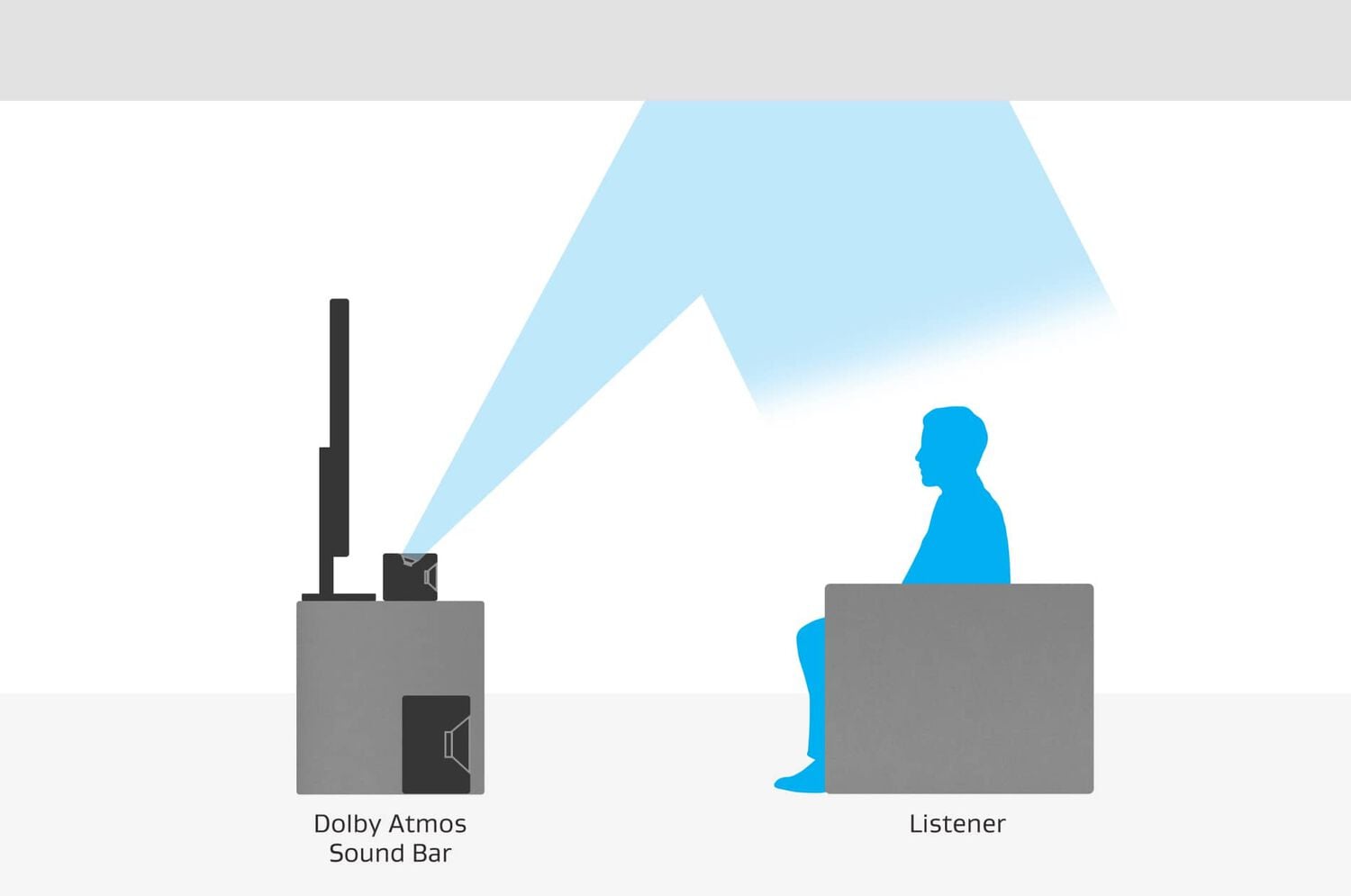

If your sound bar features upward-firing drivers, make sure they have a clear path to the ceiling.
                Up-firing height drivers aim sound at the ceiling, where it reflects back down to the listener. Courtesy of Dolby Laboratories

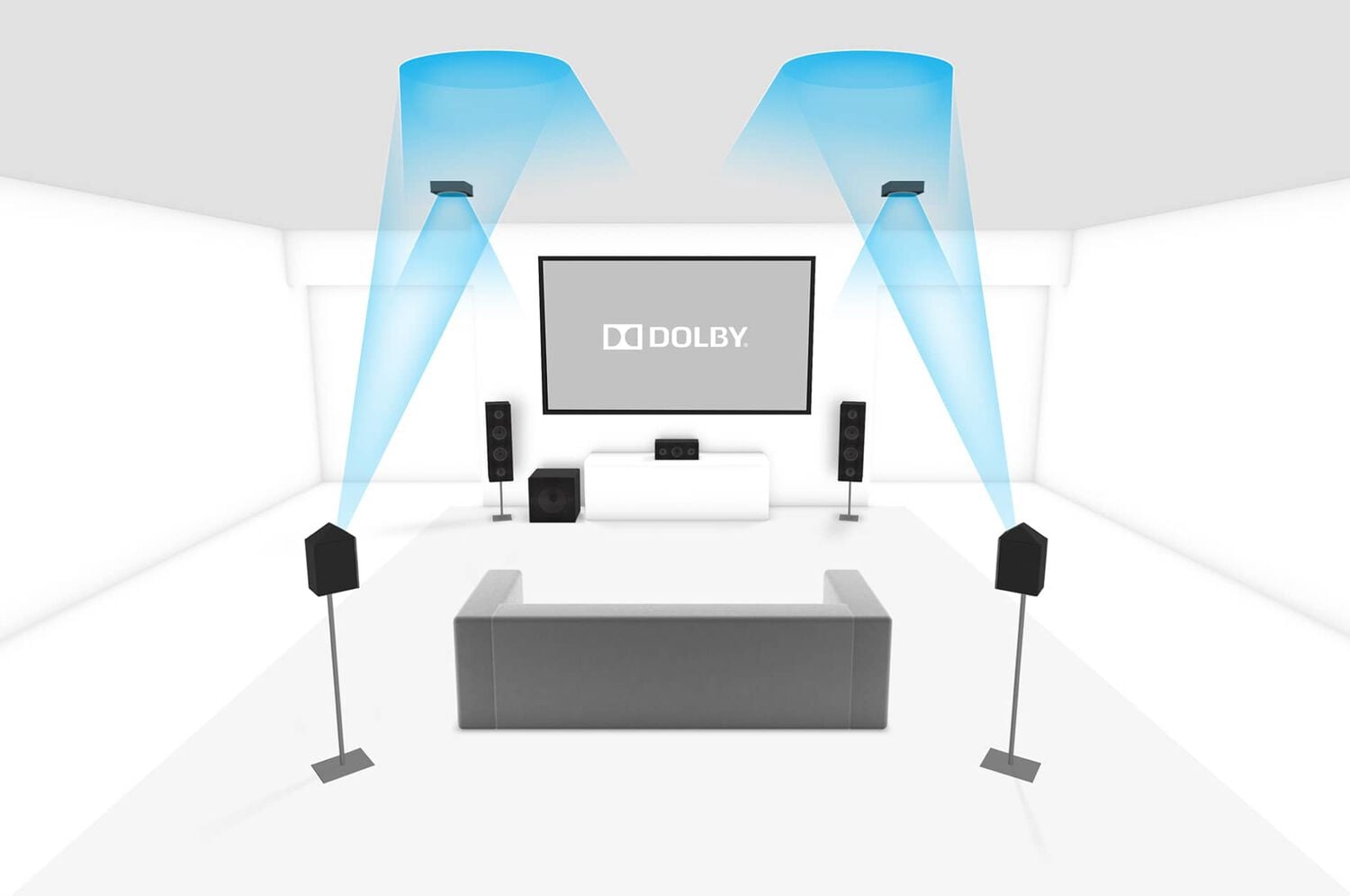

HEIGHT SPEAKERS
Atmos-enabled height speakers can be forward-facing speakers with built-in height drivers or modules that sit on top of standalone speakers.
Atmos upfiring speakers work best at ceiling heights between 7.5 and 12 feet. For best results, the ceiling should be flat and constructed from rigid, acoustically reflective material. Avoid ceiling acoustic tiles, which absorb the overhead sound. That said, Atmos is somewhat forgiving; popcorn ceilings, vents, and can lights don’t compromise the effect.
To experience the most precise, realistic overhead sound, Dolby recommends installing a minimum of four height speakers. Whether height speakers are integrated or add-on modules, if they are serving as main height modules they should be placed in the left front and right front speaker location. The other two should be positioned in the rear surround locations.
Place Atmos height speakers at or slightly above your ear height when seated, and avoid placing them higher than one-half the height of your wall. Polk's Reserve and Monitor XT Series height speakers can be conveniently wall mounted or seamlessly placed atop tower speakers in the series.
                If you only use one pair of height modules, place them on the front left and right speakers.
