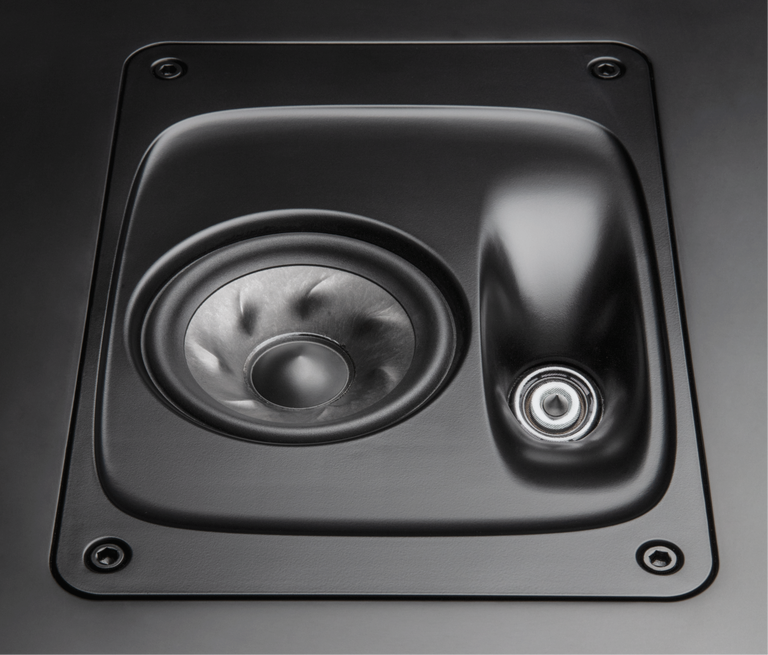

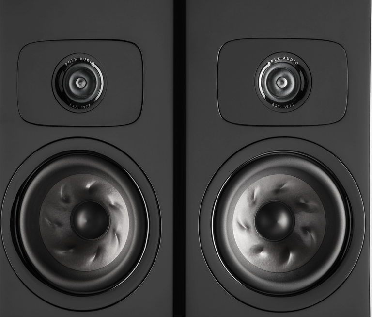

If you want an immersive experience that no other technology can deliver, the L800 speakers are for you. Built on the legendary SDA technology that became synonymous with Polk innovation, you will be absolutely blown away by this true flagship experience. Note: These speakers are sold individually with specific Left and Right variations. You must add both to your cart to receive a stereo pair.

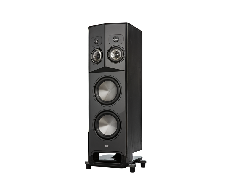

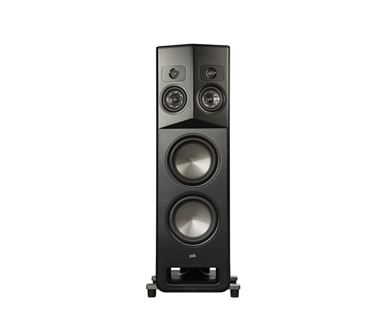

  • Dual 10" drivers
  • 5.25" Turbine Cone woofers
  • Dual 1" Pinnacle Ring Radiator tweeters
  • Enhanced Power Port® for better bass
  • Iconic cabinetry engineered for max performance
  • SDA-PRO technology for lifelike stereo imaging

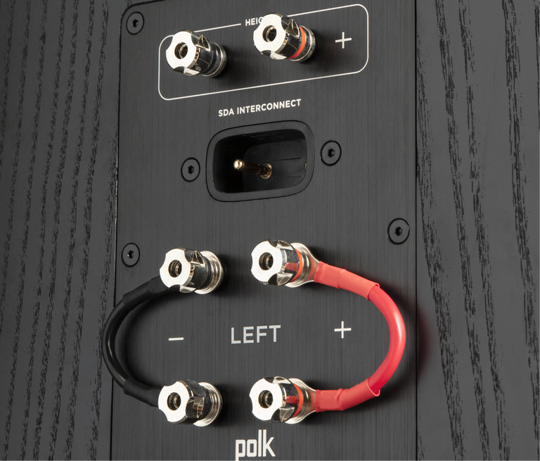

    • (1) SDA Interconnect Cable (12 ft)
