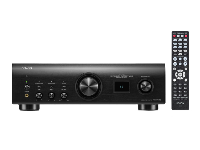

Denon PMA-1700NE
2 Ch. 70W integrated Amplifier with USB-DAC
Featuring advanced ultra-high current single push-pull circuit power, Advanced AL32 Processing, and MM/MC phono equalizer, the Denon PMA-1700NE integrated amplifier delivers extraordinary sound quality with precise detail.
  • Stereo amplifier
  • 70W per channel (8 ohms)
  • AL32 Processing
  • USB-DAC
  • Precise electrical controls
  • MM/MC phono

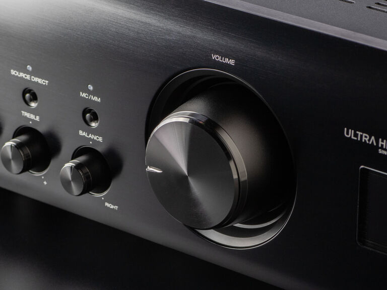

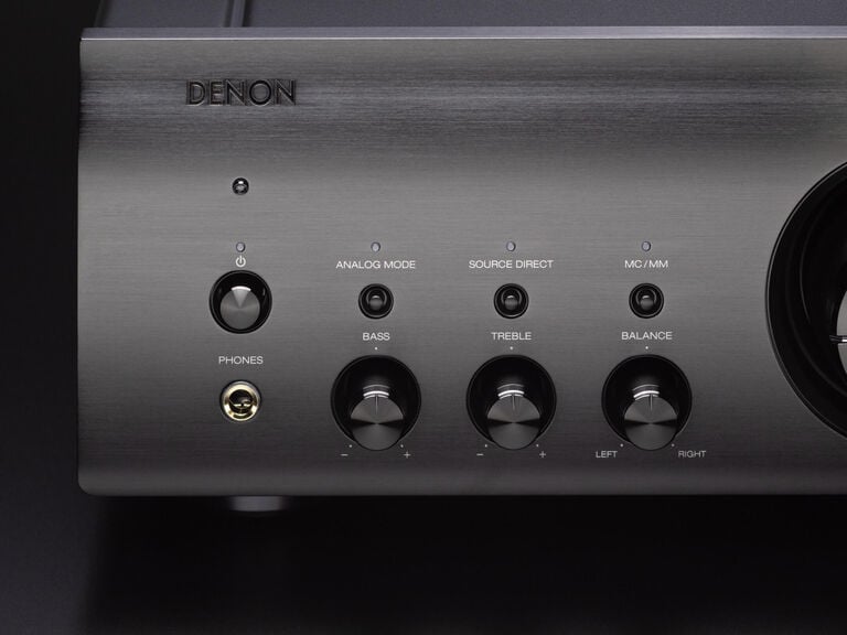

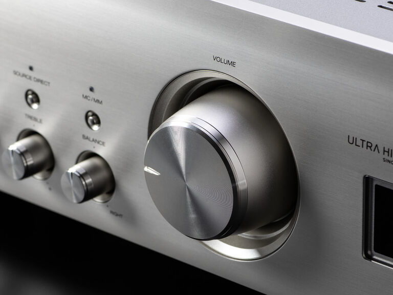

The PMA-1700NE embraces electrical volume, balance, and tone controls while preserving the analog feeling of operation. The unique mechanism offers smooth, linear control.

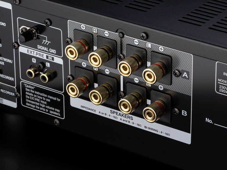

  • Speaker Impedance A or B : 4 ~ 16ohm
    A + B : 8 ~ 16ohm

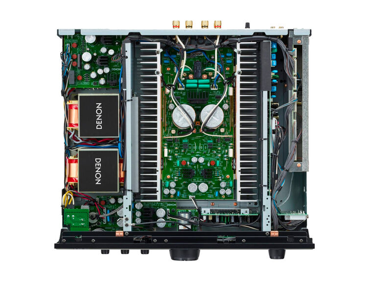

  • Power Amplifier Circuit New UHC-MOS
    Single Push Pull (7)
  • Power Trans Dual El Core
  • Pre Amplifier Circuit Variable Gain Preamplifier
    (OP AMP)
  • Volume Electric
    (MUSES 72323)
  • Bass / Treble / Mid / Balance Control Yes / Yes / No / Yes
  • Type of Tone Control Electric
    Controlled by Potentiometer

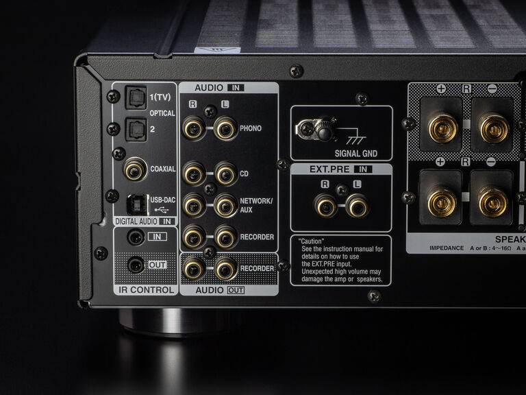

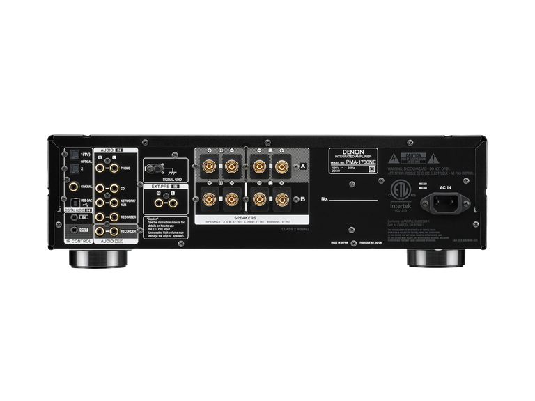

  • Phono Input Yes (MM / MC)
    *default=MM

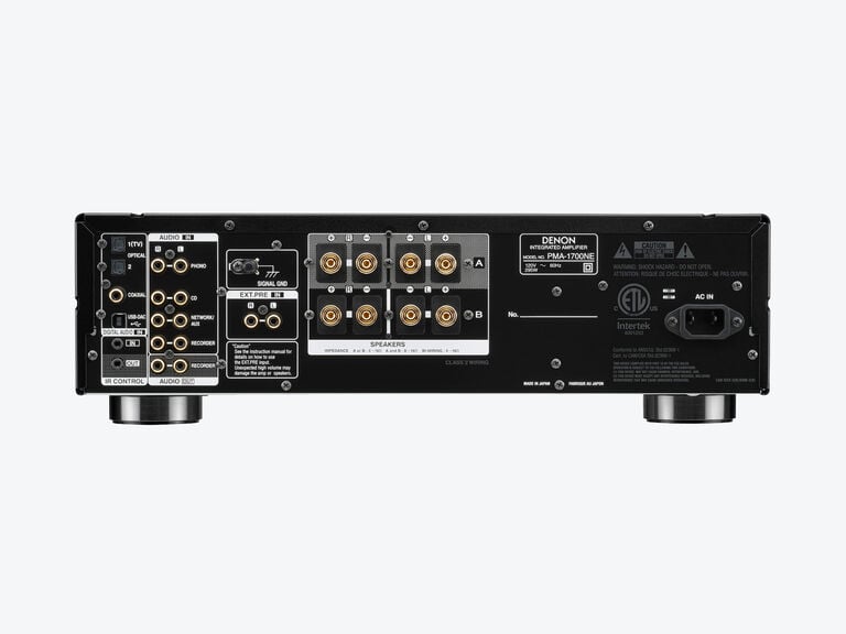

  • Analog Input (include Phono) / REC Out (RCA) 4/1 (PHONO/ CD/ AUX/ RECORDER)
  • Optical input / output (Maximum Support) 2 / 0 (192kHz/24bit)
  • Coaxial input / output (Maximum Support) 1 / 0 (192kHz/24bit)
  • Ext. Pre Input (Power Amp Direct) Yes(Ext.Pre)
  • 2 sets of Speaker Output Yes (Bi-wiring)
  • Speaker Terminal Gold Plated
  • Headphone Output 1
    (Turn off the speaker when inserting headphone)
  • Remote Control Bus Terminal Yes (mini)
  • AC Inlet Yes
  • Wi-Fi No
  • HEOS No
  • USB B (USB DAC) 1 (Rear)

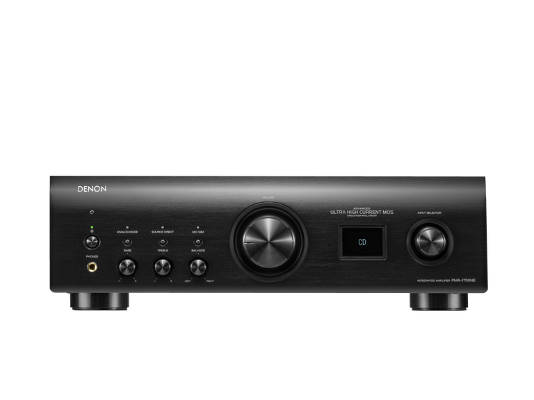

  • Unit control (Button) Push Switch: 1
    POWER
    Tact Switch : 3
    ANALOG MODE, SOURCE DIRECT, MM / MC
  • Unit control (Knob) 5
    VOLUME, INPUT SELECTOR, BASS, TREBLE, BALANCE
  • LED POWER: 1 Red / Green
    ANALOG MODE: 1 Green
    SOURCE DIRECT: 1 Green
    MM / MC :1 Green
  • Front Panel Display Yes
    (OLED 128 x 100 dot)
