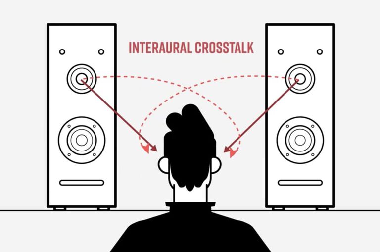

When that performance is recorded and replicated on two stereo speakers, the left speaker reproduces left-channel information while the right channel produces right-channel information. The channels are reproduced separately, but the instant the sound enters the room, the channels are no longer separated. We hear the sound coming from the left speaker in our left ear, and the sound coming from the right speaker in our right ear—but we also hear some of the sound from the left speaker crossing over into our right ear, and vice versa.
This natural distortion, called interaural crosstalk, makes it difficult to tell where sounds are coming from, like we can in the real world.
When we listen to traditional speakers, we’re getting sound cues about where the speakers are located, instead of the location of the sounds in the mix as they were meant to be presented. This tells our brain that the soundstage is constrained between the speakers. A lot of the spaciousness and sonic realism of the original recording is lost.
![](https://www.polkaudio.com/dw/image/v2/BGJH_PRD/on/demandware.static/-/Library-Sites-polk_northamerica_shared/default/dw43be62f1/Inside-Polk/Sda-Technology/Blog-Polk-Sda-Technology-Supersized.jpg?sw=768)
The SDA Solution for True Stereo
At Polk, we weren’t the first people to recognize this phenomenon, but we were the first to solve the problem acoustically with our Stereo Dimensional Array, or SDA, which we developed back in the 1980s.
Polk speakers and sound bars with SDA technology have a second set of drivers, called a dimensional array, alongside their traditional drivers. These SDA drivers produce a signal that’s out of phase with the interaural crosstalk signal coming from the opposite channel. (Phase cancellation occurs when two sound waves of the same frequency are 100 percent [or 180 degrees] out of sync, nulling each other out.)
When these signals arrive at your ear at the same time, they cancel each other out, leaving only the good, or true, stereo signal. Since the crosstalk is gone, our brain stops localizing sound to the speakers and the soundstage opens up. Sonic images are reproduced with pinpoint accuracy as if the performance was happening live, right in front of you. Recordings come to life with extraordinary depth, and spaciousness, whether you’re enjoying your favorite movie or playlist. And, it’s all done without altering the recorded material in any way.
