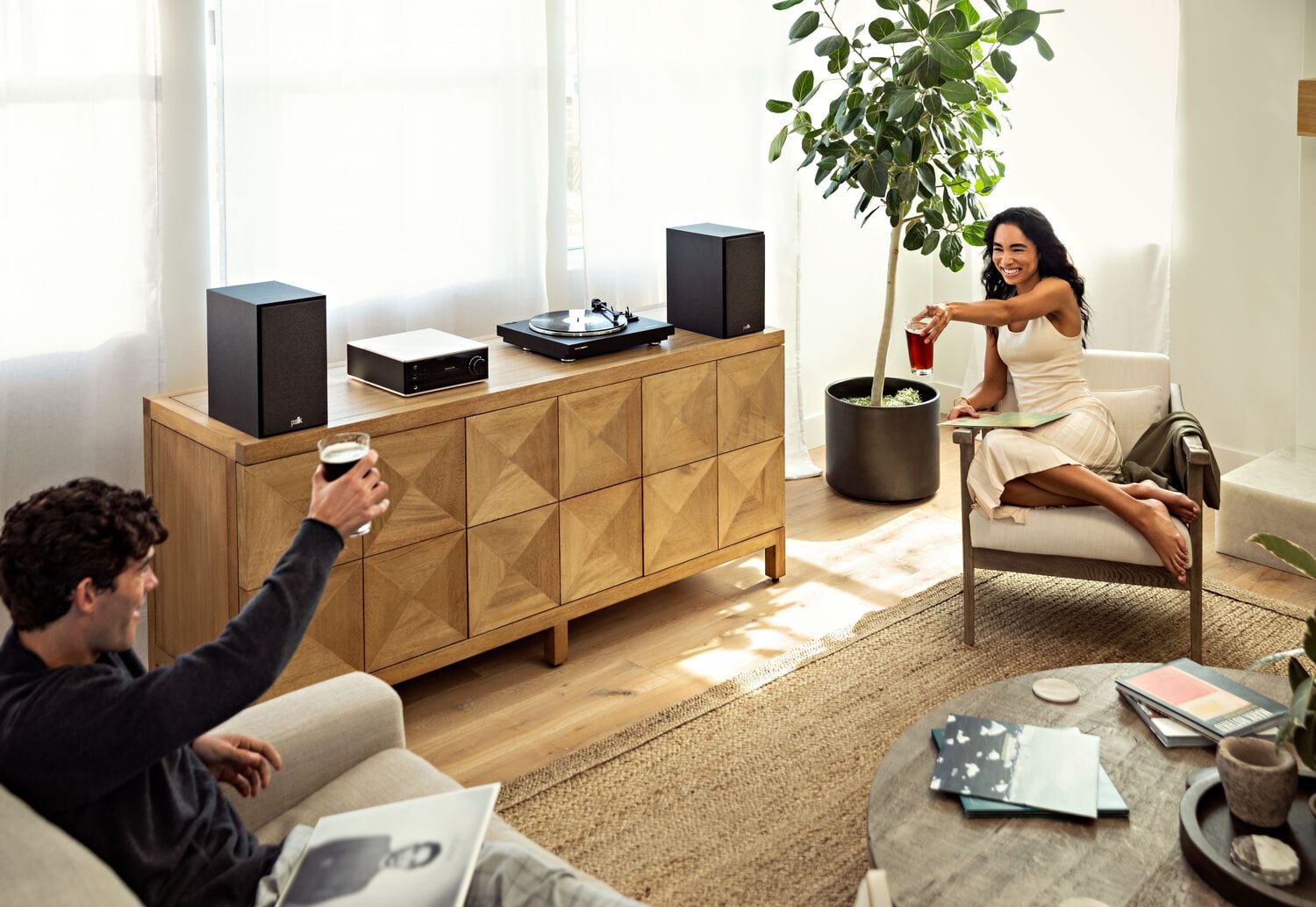

A couple raising a glass to eachother
Curtains, soft furniture, and even plants break up sonic reflections.

Soften Your Space
When you play sound through speakers in a room, you hear a combination of direct sound, which comes from your speakers; and reflected sound, which is sound that bounces off walls and other surfaces on its way to your ears. Reflected sound can add a sense of space (think of the gorgeous echo in a cavernous cathedral), but too many reflections can muddy up sound, resulting in boomy bass, harsh midrange, unintelligible speech, and a smeared soundstage.
In an ideal world, everyone’s listening room would house precisely positioned speakers and acoustically optimizes surfaces. We recognize that your home is not a recording studio, but you can still make major strides toward minimizing reflections and boomy bass-y areas without disrupting your space.
When it comes to room reflections, the culprits tend to be big, open expanses of hard, smooth surfaces: windows, mirrors, tables, doors, and wood or tile floors. While you probably can’t do much about your room dimensions, adding furniture and rugs helps absorb sound and break up reflections. Curtains, bookshelves, pillows, even that trendy rubber plant you’ve been eyeing all diffuse sound. Try rearranging furniture; avoid placing large reflective surfaces directly opposite your speakers. Need more help? Many off-the-shelf acoustic panels can be customized with designs of your choice, doubling as wall art.

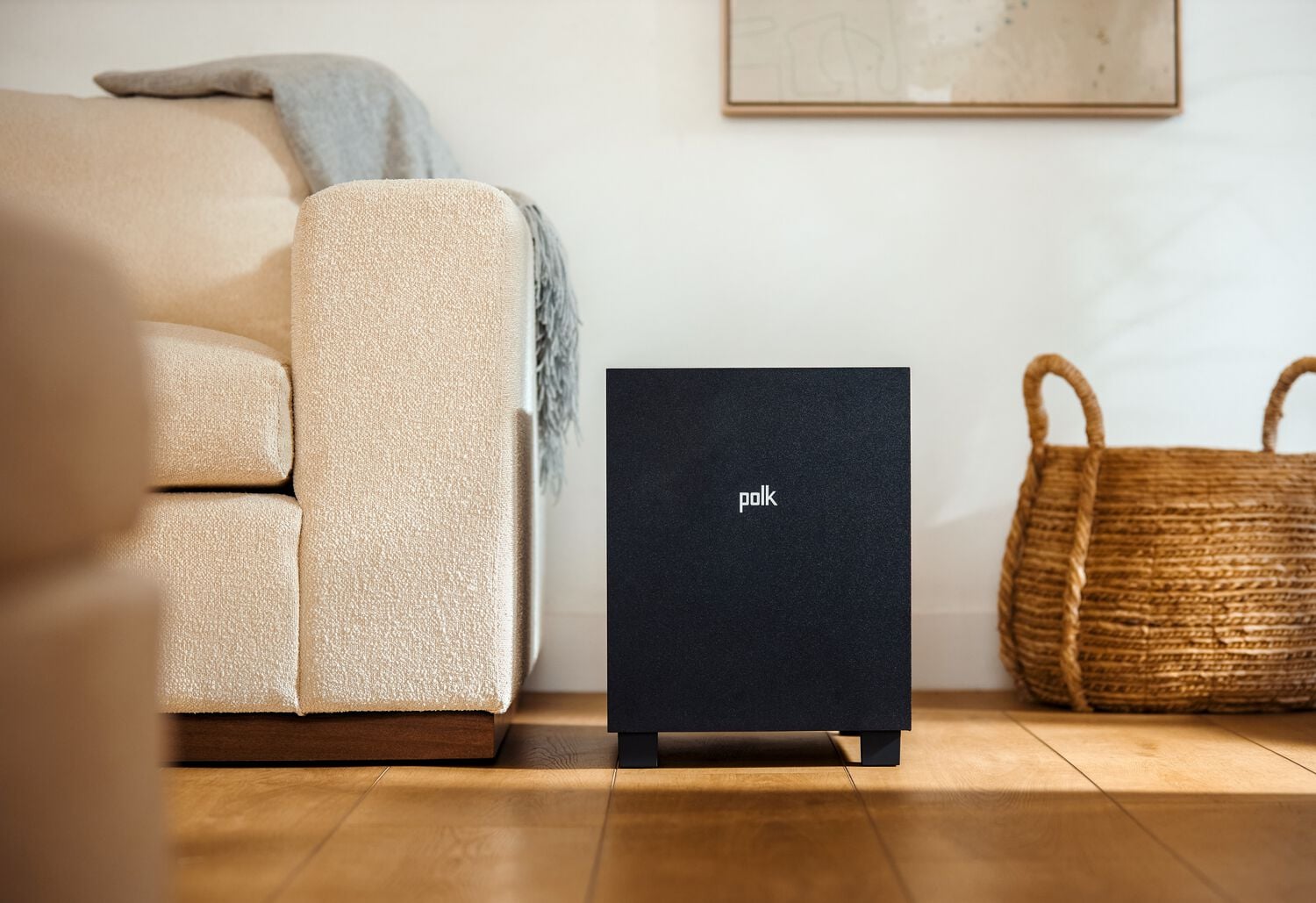

Subwoofer Placement for the Most Balanced Bass
Finding the perfect spot for your subwoofer can be tricky. You may have heard that a subwoofer can be placed anywhere in the room; while that’s partially true, your subwoofer will perform better in some spots than others. Because subwoofer performance is somewhat defined by its interaction with your unique space, finding the ideal position may involve trial and error. Try some of the same tips you tried for speaker placement: Follow the rule of thirds and keep your sub away from walls and corners. For more suggestions, read our guide to subwoofer placement.
For best bass response, place your subwoofer at least six inches from a wall.
