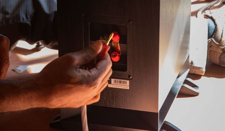

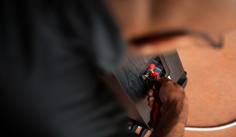

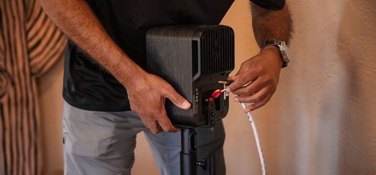

Wiring made easy
Ready for the “hard” part? Spoiler: it’s four easy steps:
  1. Cut the speaker wire to length.
  2. Strip about half an inch of insulation.

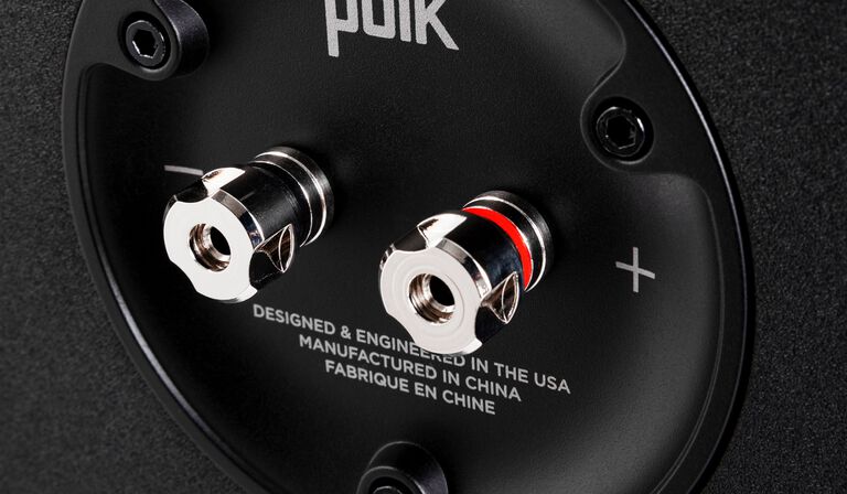

  3. Connect the positive wire from your AVR’s left red “+” output to the red “+” terminal on your left speaker, and the AVR’s left black “–” output to the black “–” terminal on the left speaker. Repeat the process for the right channel. (Think of it like jump-starting a car—red to red, black to black—only way less risky.)
  4. At each connection, loosen the red and black knobs, slip the bare wire into the hole, then tighten each knob until the wire is snug.
Helpful tip: Speaker wire is often color coded red and black or is marked with a stripe, texture, or colored jacket to help you easily match ends.
