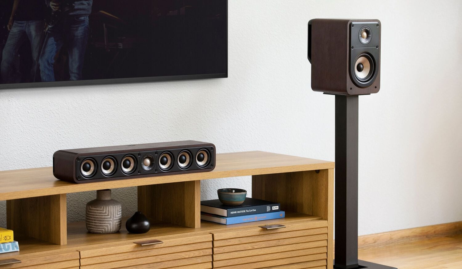

The Signature Elite ES35 center channel and ES15 bookshelf speakers form a low-profile yet powerful front stage.

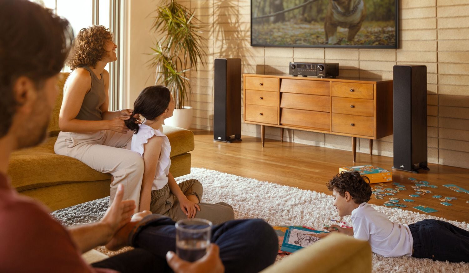

If your AVR supports 5.1, you’re set. That means it powers five speakers and has an output that connects directly to your powered subwoofer. Connect the new speakers, run your receiver’s auto-calibration, and enjoy surround.
If your receiver only supports stereo or 2.1, upgrading to an AVR with more channels of power, like the Denon AVR-S760H, opens the door to 5.1 and beyond. With 7.2 channels, 8K video support, and Dolby Atmos decoding, the AVR-S760H handles 5.1 surround now and leaves room to add height speakers later for an immersive 5.1.2 or 5.2.2 setup.

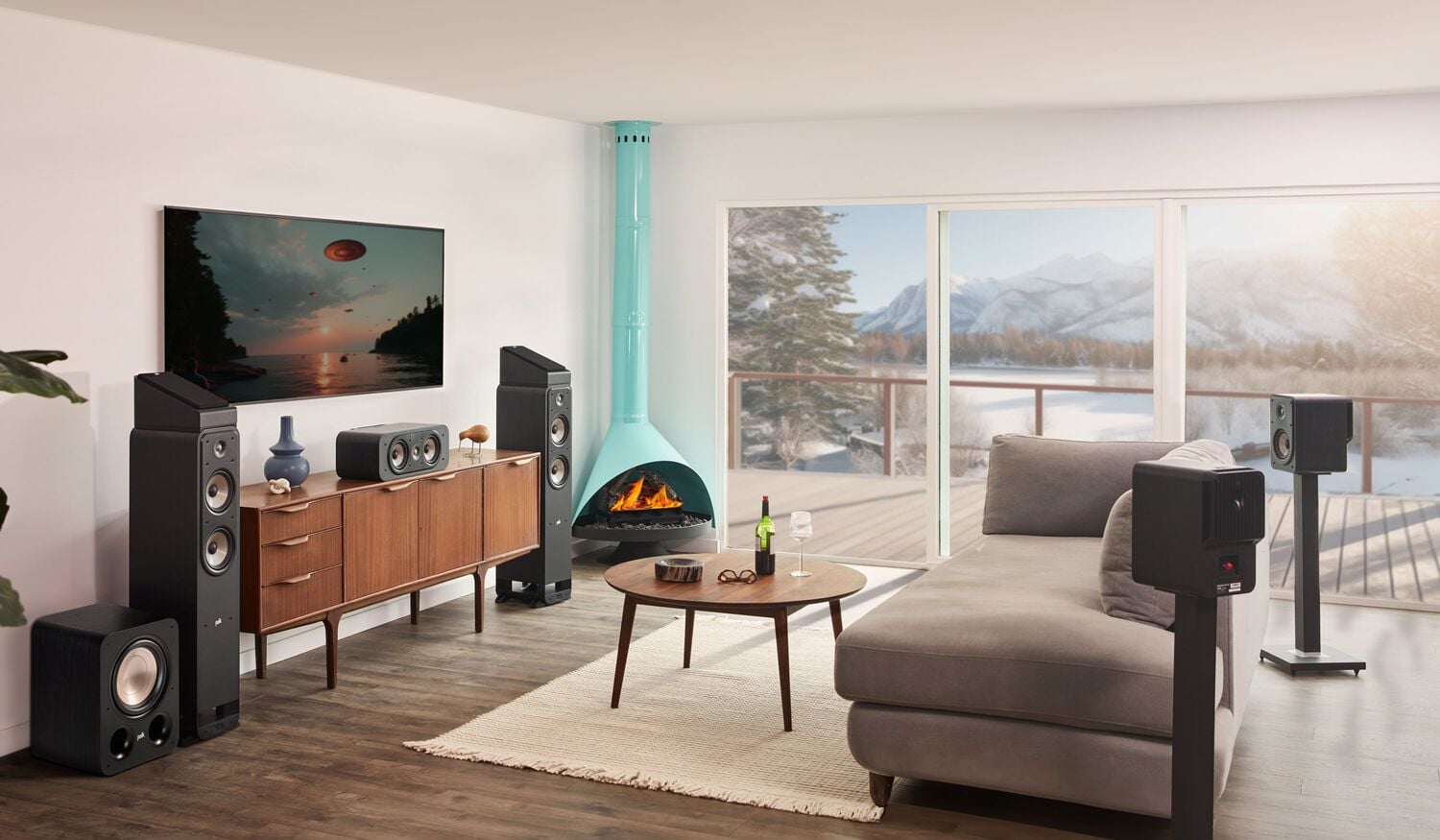

Signature Elite ES50 towers fill even the largest rooms with sound.
An all-in-one surround setup
Starting from scratch? Polk’s Signature Elite 5.2 Surround Sound Speaker Bundle includes every speaker you need to experience true home theater sound: ES50 towers for left and right, an ES35 center channel speaker for dialogue, two ES10 surrounds, and two ES8 subwoofers. This dual-sub system delivers even smoother, more balanced bass throughout the room—an upgrade that takes standard 5.1 performance even further.
Every Signature Elite speaker is timbre-matched, sharing the same voicing and tonal balance. That consistency keeps voices and instruments sounding uniform and natural as they move between speakers, so the entire system feels cohesive and true to the source. And if you decide to expand your system over time, timbre matching ensures each new speaker blends seamlessly with the rest, maintaining that same balanced, signature Polk sound.

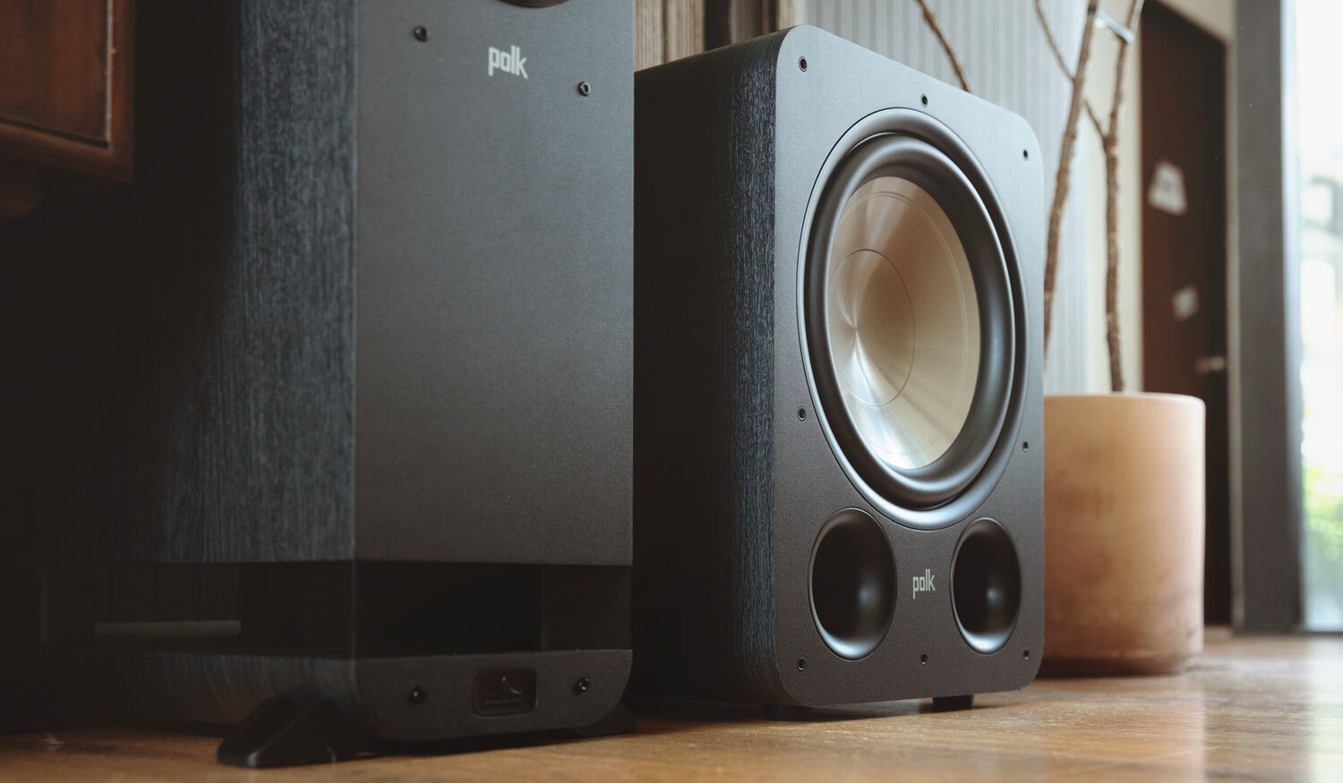

The 12-inch Signature Elite ES12 subwoofer delivers bass you can feel.

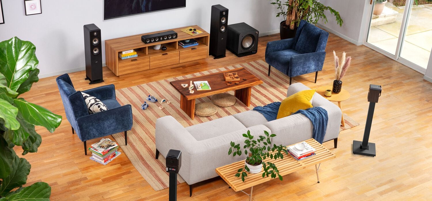

Putting it all together
Setting your system up takes a little patience and attention to detail, but it’s worth it. Careful speaker placement makes all the difference—small adjustments can turn good sound into something extraordinary.
  • Center channel: Ideally, your center channel sits just below your TV and aimed at ear level. If you need to place it above, tilt it down slightly so dialogue still sounds like it’s coming from the screen, not above it.
  • Front L/R towers: Place them slightly angled toward your main listening spot so the sound from each speaker meets where you sit, creating a focused, balanced soundstage.
  • Surrounds: Position them to the sides or just behind your couch, a little higher than ear level when seated. Point them toward your listening area to fill the space evenly.
  • Subwoofer: Start near a front corner or along the front wall; if bass sounds boomy or thin, move it slightly. Feeling ambitious? Try our five tips for perfect sub placement. (With two subs, try placing them both along the front wall or place the second sub diagonally away from the front subwoofer, along the back of your listening area.)
